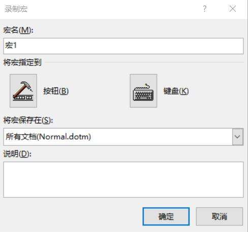

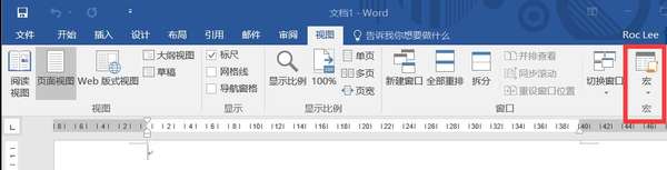

    使用宏的话,这个问题可以「一键解决」。只要在「宏」选项上选择「录制宏」,然后按照往日的顺序,操作那四次「全部替换」,然后在「宏」选项上选择「停止录制」,一个新的宏就诞生了。
    如果开始录制的时候选择了「将宏指定到按钮」,则根据你的设置,Word 的面板上会有一个该宏的按钮。
    如果选择的是「将宏指定到键盘」,则根据你的设置,该宏有一个特定的快捷键。

    当然,你也可以不指定快捷方式,而是通过「查看宏」到宏列表中选择想要编辑或使用的宏。

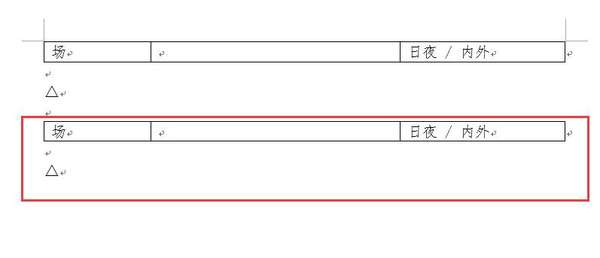

    每次重新插一个表格或者去复制上面的表格总是太麻烦。所以我们照样可以用「录制宏」来把插入表格的动作记下来。
    我给公司做的这个宏,代码如下:
    Sub 开始一个新的场景() ' ' 开始一个新的场景 宏 ' ' Selection.Font.Name = "仿宋" Selection.Font.Size = 12 With Selection.ParagraphFormat .LeftIndent = CentimetersToPoints(0) .RightIndent = CentimetersToPoints(0) .SpaceBefore = 0 .SpaceBeforeAuto = False .SpaceAfter = 0 .SpaceAfterAuto = False .LineSpacingRule = wdLineSpaceSingle .Alignment = wdAlignParagraphJustify .WidowControl = False .KeepWithNext = False .KeepTogether = False .PageBreakBefore = False .NoLineNumber = False .Hyphenation = True .FirstLineIndent = CentimetersToPoints(0) .OutlineLevel = wdOutlineLevelBodyText .CharacterUnitLeftIndent = 0 .CharacterUnitRightIndent = 0 .CharacterUnitFirstLineIndent = 0 .LineUnitBefore = 0 .LineUnitAfter = 0 .MirrorIndents = False .TextboxTightWrap = wdTightNone .CollapsedByDefault = False .ReadingOrder = wdReadingOrderLtr .AutoAdjustRightIndent = True .DisableLineHeightGrid = False .FarEastLineBreakControl = True .WordWrap = True .HangingPunctuation = True .HalfWidthPunctuationOnTopOfLine = False .AddSpaceBetweenFarEastAndAlpha = True .AddSpaceBetweenFarEastAndDigit = True .BaseLineAlignment = wdBaselineAlignAuto End With ActiveDocument.Tables.Add Range:=Selection.Range, NumRows:=1, NumColumns:= _ 3, DefaultTableBehavior:=wdWord9TableBehavior, AutoFitBehavior:= _ wdAutoFitFixed With Selection.Tables(1) If .Style <> "网格型" Then .Style = "网格型" End If .ApplyStyleHeadingRows = True .ApplyStyleLastRow = False .ApplyStyleFirstColumn = True .ApplyStyleLastColumn = False .ApplyStyleRowBands = True .ApplyStyleColumnBands = False End With Selection.TypeText Text:="场" Selection.Range.Cells(1).PreferredWidthType = wdPreferredWidthPoints Selection.Range.Cells(1).PreferredWidth = CentimetersToPoints(3.5) Selection.MoveRight Unit:=wdCell Selection.Range.Cells(1).PreferredWidthType = wdPreferredWidthPoints Selection.Range.Cells(1).PreferredWidth = CentimetersToPoints(8.5) Selection.MoveRight Unit:=wdCell Selection.TypeText Text:="日夜 / 内外" Selection.Range.Cells(1).PreferredWidthType = wdPreferredWidthPoints Selection.Range.Cells(1).PreferredWidth = CentimetersToPoints(5.5) Selection.MoveRight Unit:=wdCharacter, Count:=2 Selection.TypeParagraph Selection.TypeText Text:="△" End Sub
    这个宏的效果就是,按一下该宏的快捷键,Word 文档里就会自动插入下图红框内的内容:

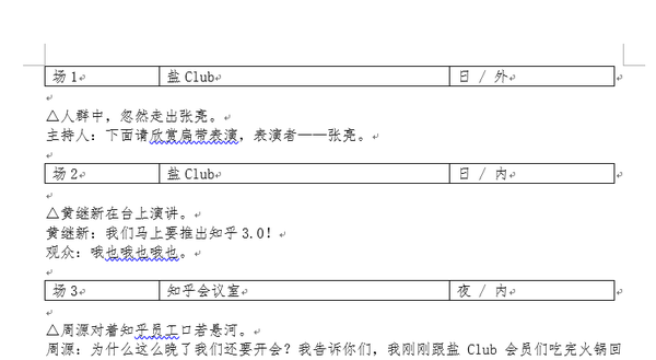

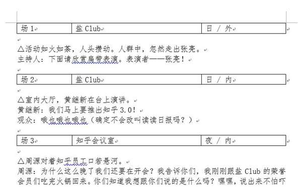

    场景表信息整理是影视行业一件等因奉此的繁琐工作,其中被我称为工作性质像「在火柴厂粘纸盒」的一步毫无技术含量的工作就是将剧本中的场景信息复制到表格里。
    也就是要拿着这样的剧本:

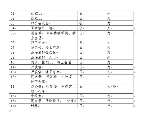

    把里面的场景信息提取出来,做出这样的成品:
    [​IMG]​
    显然,一条一条去复制粘贴整理真的是一件十分枯燥无趣的事情。

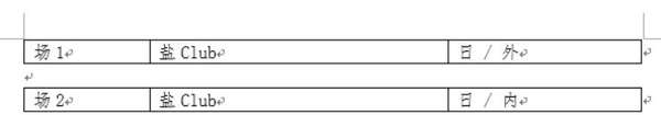

    3.2.5、再按一下删除键,使光标到达下个场景的场景信息表格行首,且下个场景的场景信息表格与上一场的信息表格合为一个表格。也就是——
    从这样
    变成了这样
    因为此时光标已位于下一场景的行首(具条到上图,就是位于「场 2」的「场」字前面),所以只要告诉计算机重复上述五步中的 3.2.2 到 3.2.5 这四步就行了。

    最后就是把场景序号里的「场」字删掉,并把场序的「1」到「9」变成「01」到「09」这样的两位数字格式。
    这样就算是完成了。但你会发现刚刚操作「日夜 / 内外」的时候在右边新加的那列表格几乎伸到页面外边去了,所以,你可以再把表格的宽度也调整一下。
    最后的成品代码,就是这样的——
    Sub 剧本转场景表() ' ' 剧本转场景表 宏 ' ' Selection.Find.ClearFormatting Selection.Find.Replacement.ClearFormatting With Selection.Find .Text = "^p" .Replacement.Text = "" .Forward = True .Wrap = wdFindContinue .Format = False .MatchCase = False .MatchWholeWord = False .MatchByte = True .MatchAllWordForms = False .MatchSoundsLike = False .MatchWildcards = False .MatchFuzzy = False End With Selection.Find.Execute Replace:=wdReplaceAll ' 将所有换行符删除 Selection.HomeKey Unit:=wdStory Selection.MoveDown Unit:=wdLine, Count:=1 Selection.EndKey Unit:=wdStory, Extend:=wdExtend '光标移到文首后,下移一行,选择光标所在处到文尾的所有内容,以判断是否还有剩余内容 Do While Len(Selection) > 2 Selection.MoveLeft Unit:=wdCharacter, Count:=1 '判断条件为选择内容长度是否大于 2 个字节,如果超过,说明还有剩余内容 Selection.Extend Selection.Extend Selection.Extend Selection.Extend '选择一个段落(删除所有换行符后,这里选择的一个段落即夹在两行表格之间的文字) Selection.Delete Unit:=wdCharacter, Count:=1 '删除这个段落(只留表格) Selection.Delete Unit:=wdCharacter, Count:=1 '再操作一次删除,使下一行表格与上一行表格合并为同一表格 Selection.MoveDown Unit:=wdLine, Count:=1 Selection.EndKey Unit:=wdStory, Extend:=wdExtend '回到循环操作状态 Loop Selection.MoveRight Unit:=wdCharacter, Count:=1 Selection.HomeKey Unit:=wdStory Selection.MoveDown Unit:=wdLine, Count:=1 Selection.MoveLeft Unit:=wdCharacter, Count:=1 Selection.InsertColumnsRight '光标移至表格最右,然后在右边加入一列新表格 Selection.MoveLeft Unit:=wdCharacter, Count:=1 Selection.MoveLeft Unit:=wdCell Selection.MoveLeft Unit:=wdCharacter, Count:=1 Selection.MoveRight Unit:=wdCharacter, Count:=1 Selection.Extend Selection.Extend Selection.Extend Selection.MoveRight Unit:=wdCharacter, Count:=1, Extend:=wdExtend Selection.MoveLeft Unit:=wdCharacter, Count:=1, Extend:=wdExtend Selection.Cut Selection.MoveRight Unit:=wdCharacter, Count:=1 Selection.PasteAndFormat (wdFormatOriginalFormatting) '将「日夜 / 内外」信息中的「内」或「外」剪切粘贴到右边新插入的这列表格中 Selection.HomeKey Unit:=wdLine Selection.Delete Unit:=wdCharacter, Count:=1 Selection.EndKey Unit:=wdLine Selection.MoveRight Unit:=wdCharacter, Count:=2 Selection.EndKey Unit:=wdStory, Extend:=wdExtend '从下一行首选择到文尾,作为判断操作是否结束的条件 Do While Len(Selection) > 1 '循环操作【将「日夜 / 内外」信息中的「内」或「外」剪切粘贴到右边新插入的这列表格中】 Selection.MoveLeft Unit:=wdCharacter, Count:=1 Selection.MoveDown Unit:=wdLine, Count:=1 Selection.MoveLeft Unit:=wdCharacter, Count:=2 Selection.MoveLeft Unit:=wdCell Selection.MoveLeft Unit:=wdCharacter, Count:=1 Selection.MoveRight Unit:=wdCharacter, Count:=1 Selection.Extend Selection.Extend Selection.Extend Selection.MoveRight Unit:=wdCharacter, Count:=1, Extend:=wdExtend Selection.MoveLeft Unit:=wdCharacter, Count:=1, Extend:=wdExtend Selection.Cut Selection.MoveRight Unit:=wdCharacter, Count:=1 Selection.PasteAndFormat (wdFormatOriginalFormatting) Selection.HomeKey Unit:=wdLine Selection.Delete Unit:=wdCharacter, Count:=1 Selection.EndKey Unit:=wdLine Selection.MoveRight Unit:=wdCharacter, Count:=2 Selection.EndKey Unit:=wdStory, Extend:=wdExtend Loop Selection.Find.ClearFormatting Selection.Find.Replacement.ClearFormatting With Selection.Find .Text = " " .Replacement.Text = "" .Forward = True .Wrap = wdFindContinue .Format = False .MatchCase = False .MatchWholeWord = False .MatchByte = True .MatchAllWordForms = False .MatchSoundsLike = False .MatchWildcards = False .MatchFuzzy = False End With Selection.Find.Execute Replace:=wdReplaceAll '删除掉所有空格 Selection.HomeKey Unit:=wdStory Selection.EndKey Unit:=wdColumn, Extend:=True Selection.Find.ClearFormatting Selection.Find.Replacement.ClearFormatting With Selection.Find .Text = "场" .Replacement.Text = "" .Forward = True .Wrap = wdFindAsk .Format = False .MatchCase = False .MatchWholeWord = False .MatchByte = True .MatchAllWordForms = False .MatchSoundsLike = False .MatchWildcards = False .MatchFuzzy = False End With Selection.Find.Execute Replace:=wdReplaceAll '删除第一列中的「场」字,只留下序号 Selection.MoveLeft Unit:=wdCharacter, Count:=1 Selection.MoveRight Unit:=wdCell Selection.MoveLeft Unit:=wdCell Do While Len(Selection) = 1 Selection.MoveLeft Unit:=wdCharacter, Count:=1 Selection.TypeText Text:="0" Selection.MoveDown Unit:=wdLine, Count:=1 Selection.MoveRight Unit:=wdCell Selection.MoveLeft Unit:=wdCell Loop '用循环将序号 1 至 9 改写成 01、02、03……的形式 Selection.MoveRight Unit:=wdCharacter, Count:=1 Selection.Tables(1).PreferredWidthType = wdPreferredWidthPoints Selection.Tables(1).PreferredWidth = CentimetersToPoints(16) '调整表格宽度 End End Sub

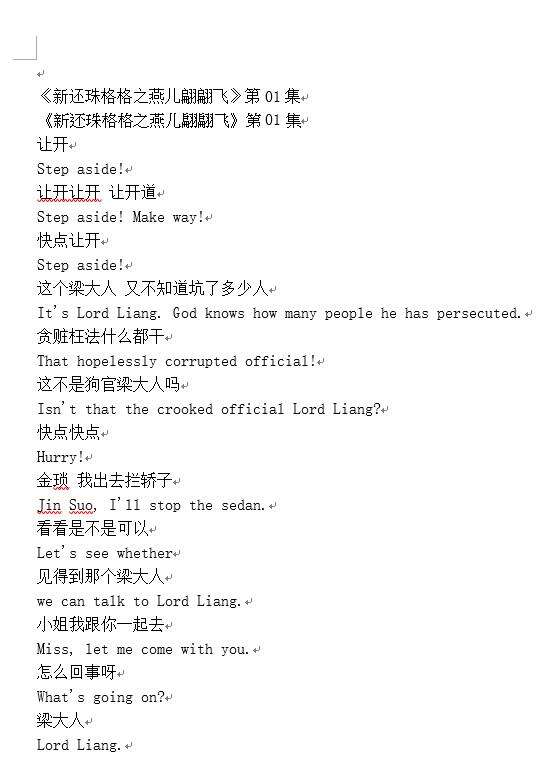

    当我在之前之前的公司做电视剧字幕翻译的时候,公司使用的翻译软件是非常不错的生产力工具,能大幅提高工作的效率。操作前后,文稿的变化是这样的——

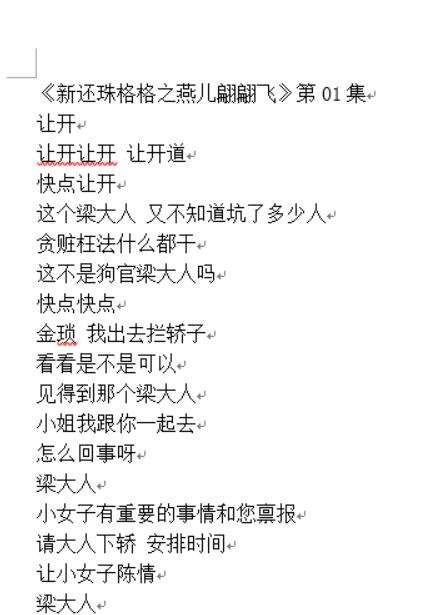

    原稿:

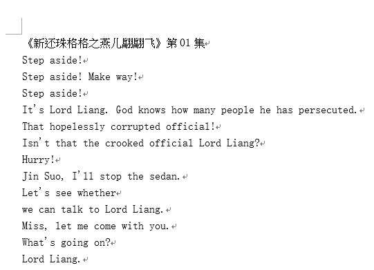

    译稿:
    (不要为《新还珠格格》感到震惊啦,《爱情公寓》我都翻过的!
    怎么把相声或者中式笑话翻译用英语翻译出来并且让老外觉得好笑? - Roc Lee 的回答)
    现在问题出现了,因为我们的译稿需要交给后期的同学去上字幕,而且字幕组(好吧这不是大家理解的那个字幕组)需要的是中英文对照的文稿,也就是这样的:
    除非我们直接在 Word 里翻译(那样就放弃了提高翻译效率的工具),否则就得在翻译完之后想办法拿原稿和译稿整理出这样一份中英对照稿。​

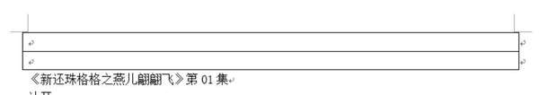

    因为不能同时操作多个文稿,所以得自己先做点准备工作。
    在 Word 里新建一个上下两格的表格,把原文全文剪切到上面的单元格里,把译文全文剪切到下面的单元格里。
